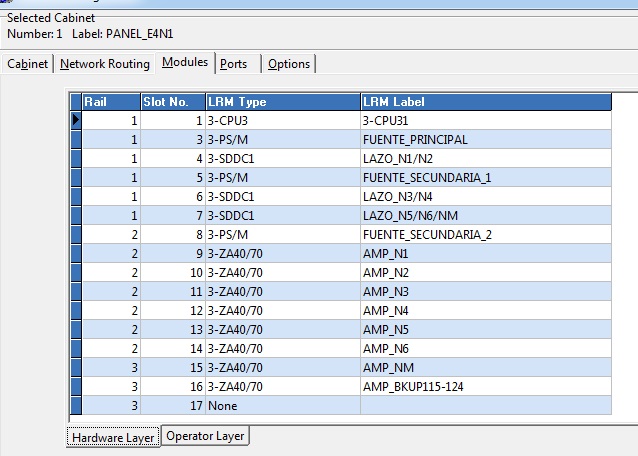

3-ssdc and 3-sddc card are only different because of the second SLC card mounted on it
does the card have the 2 SLC boards mounted on it or 1
if 1 SLC card it is a 3-SSDC card if 2 it is a 3-SDDC card
does the program match what you installed

thank you for you reponse Leo, effectively, i have two 3-SDDC1 cards installed in one panel, three in other panel, and these are the same model configured in sdu.

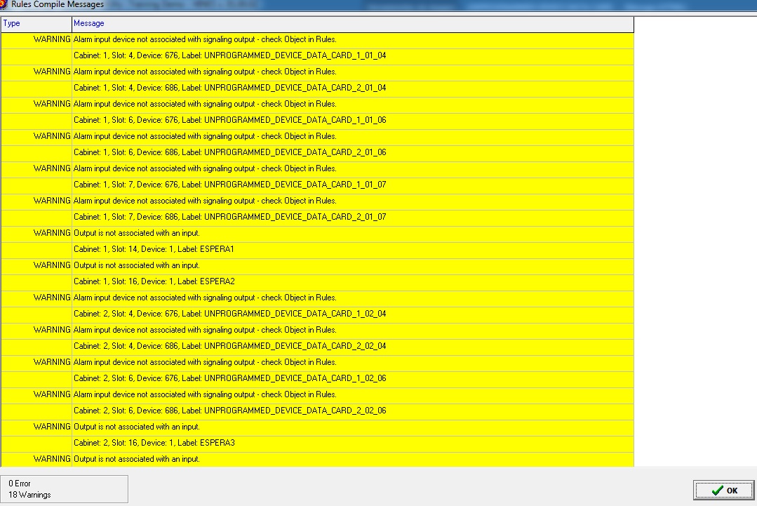

I KNOW THAT THIS IS A PROBLEM THAT STAY INTERLOCKED WHEN YOU COMILE THE RULES WITHOUT RULES OR SIMILAR OR SCANN DEVICE UNPROGRAMMED

HI! I I have a problem with est3 panel, when I compile de rules its show the warning message: UNPROGRAMMED DEVICE DATA CARD, with pseudopoints 676 and 686, I have assign all inputs and all outputs, this 2 pseudopoints are show in all 3-sddc. I don’t know whats the problem.
I made a new project without rules, just added the loop cards, then compiled and I get the same error.
